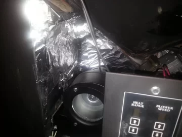

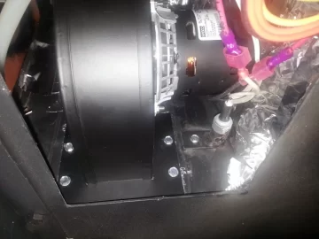

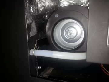

Any gasket between that blower flange and where it mounts on the stove?
Would you take a few pictures of the blower inside the stove and post them.
Is there anything blocking any of the holes in the shell of the stove?
Hi Smokey, I took some pics of my setup. All of the surrounding areas in the stove are cool to the touch, including the blower housing. The gasket is new and in place. I triple checked all of the wiring and that is good. Blower fan is balanced and not vibrating.
Im thinking about putting a small computer fan to assist in cooling the motor.
But anyway, here are some pics. [Hearth.com] New convection blower is in.[Hearth.com] New convection blower is in. [Hearth.com] New convection blower is in. [Hearth.com] New convection blower is in. [Hearth.com] New convection blower is in.
