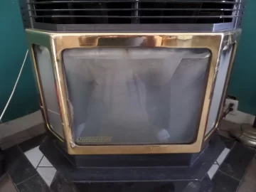

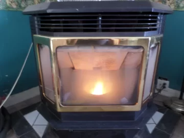

My Husband has again done a complete yearly cleaning needed or not, including outside stovepipe. Within 30 minutes of the restart the glass is turning black. As you mentioned we also now believe it’s the pellets. Early in the Fall we didn’t have this issue probably because they were pellets were left from last season or early on. It seems all the pellets no matter where we are purchasing them from are causing the issue. Hopefully we won’t have such a wet summer again this year.
  • [Hearth.com] New England Stove Works Pellet stove Soot Lazy Fire

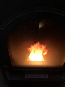

How is the Cap up top? Clogged? Sure looks like poor airflow vs pellets. I had similar and it was cap was clogged a bit. Look at the smoke coming out. Seem right? Should be some. We had very wet Spring were I live and pellets were just fine. Heck I burned 5 bags of wet ones with lots of clumping and did not have any problems. 2nd Picture to me looks normal.

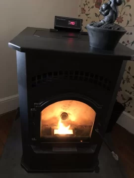

just cleaned and washed glass about 6 hr's ago
[Hearth.com] New England Stove Works Pellet stove Soot Lazy Fire [Hearth.com] New England Stove Works Pellet stove Soot Lazy Fire

Did you see my reply to you above and my photos. It seems your photos and mine are pretty much the same. So I think we now know the issue. Thanks again.

Thank you for responding to my question. Everything is cleaned and no clogs. My pictures came out reversed. The nice clean photo, picture number two is actually picture number one when it was first lit.
yes i saw it. you could raise your combustion blower speed a little and see if it helps. but im still searching for some clean burn pellets! getting a ton of Lignetics this week hope there atleast a little better. that will take me into warmer weather i hope
