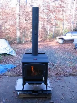

I would burn it outside and get it up to about 500F to bake the paint. Use some cheap pipe for a temp chimney. It is going to draft very poorly so you may need to keep the door slightly ajar to get it that hot.

I would burn it out side. I've done it both ways, but prefer outside.
Here's yer shirt.
[Hearth.com] New Englander 13 will be here tomorrow!
Reactions: Dix
Burn it in outside.

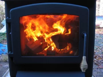

When it gets to five hundred degrees and over you will see and smell why.
[Hearth.com] New Englander 13 will be here tomorrow![Hearth.com] New Englander 13 will be here tomorrow!
Reactions: DexterDay
BB - is you 30nc door open in the pics? Just curious because mine sits at about 4pm when shut and noticed yours is hanging at 6pm.
OP - if I had the option I would burn it outside. I did not get that option because the delivery crew brought it right in for me(for a small tip) and I was grateful for that. The burn in was not to bad as far as smell but it had my detectors buzzing and was a lil frustrating.
Yeah. Had to keep it cracked open on a warm November day with a six foot pipe. The biggest problem was keep the leaves brushed off of it. They were falling like crazy.
