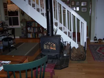

After 6 frustrating years of trying to get my Jotul 3 to burn effectively with little success-even with all kinds of valuable advice from this site, I began to look for another stove. The Englander had caught my eye right away for reasons of look, footprint/clearances, the positive comments on this site about the stove, and the fact that one of its own was involved in its development. Once I got the wife go ahead I made the move. Jotul out-Englander in.
In fairness to Jotul and a relief for me we discovered that an improper install of the Jotul might have been the culprit. The installer did not use the included top flue collar adaptor, merely used a crimped end to insert it, never attached it to the stove and it later rode all the way up into the slip connector that had been placed over it.

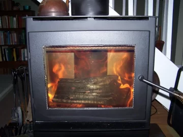

It takes a while to get going, and I think there's a learning curve in that. Once it's cranked up it seems to cruise effortlessly at @550 and stay there even as the half full firebox burns down. I haven't really let it go yet since it's about 70 degrees outside and I'm still getting to know this stove and my wife has only so much patience. But his thing is not just some bonfire in a box, it clearly has its way of burning. The manual talks about charring before achieving a good burn and it's true. You can see the efficiency of the burn right before your eyes. Better than TV. I'll try to upload some pix if I can figure it out.

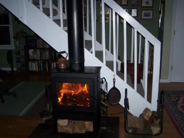

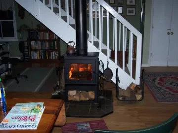

[Hearth.com] New Englander 17 vl up and running--beautifully[Hearth.com] New Englander 17 vl up and running--beautifully
Old stove- pretty face New stove-pretty hot
First charred burn after breakin Better than TV
I would not describe the blower as whisper quiet, more like all business. But it moves some serious hot air especially if you're looking for curculation. My old stove could not turn corners this blower does that. It's strictly a manual contol, off/low/high, but it's easily accessable at the cooler rear of the stove and if you want it you turn it on, when you've had enough turn it off, not something you'd leave on overnight.
I hope this pix upload works.
