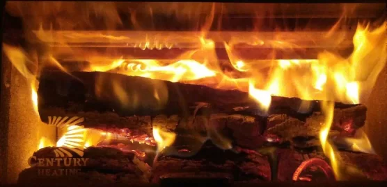

Success.
A layer of 6 Bio Bricks and 1 split on top. Best fire to date. There is flame in every corner of the box and we're cruising along at 650°.
Wife and kids have evacuated to the far end of the house.
Here's a pic 1 and a half hours in. Air is 75% closed.

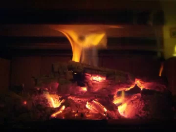

About 3 hours in and still ~600°. Substantial flames and a mound of glowing coals. I should see 4 hours before the last of the flames go out.
Here's what I had at the 4 hour mark. All in all, I'm quite satisfied.
[Hearth.com] New Guy; forced into burning for primary heat.
Did you have to turn up the intake air towards the 4 hour mark?
Yea I increased it to 50% right before I took that pic.
Thought maybe.
In the dead of winter I can get 12 hours easy off my BK with a 2/3 load of hardwood. Then if I open the air way up I can get another 3 hours of good heat plus that helps with burning the coals down. Sometimes I even sprinkle some pellets onto the coals to get some hot flame during that process.Two or three cup fulls.
I think 12 hours out of my little stove would be a pipe dream but, are you saying that I can increase the burn time 25% by opening up the air at the end of the burn?
I'm just saying that sometimes I can. Your millage may very lol. Cheers!
Comparing a big BK cat to a small Century is apples to oranges. They are two different animals. The mileage will almost always vary.
True but maybe he will increase his burn time by maybe up to 25% ...thinking about it 4 extra hours with the air all the way may be a little high..but I know I can get 3 extra hours most times. I also may stir up things with the poker and add some pellets also once or twice during that time.
