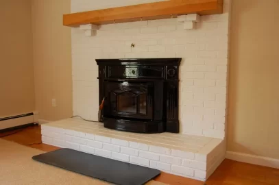

Hi guys,
Install day finally arrived yesterday, and wouldn't you know it, the weather FINALLY warms up and we'll be in the 80's all week :-)
Thanks for all your advice -- everything seemed to go smoothly. The install was done by 2 guys in about 3 hours. They installed a full-length 5.5" x 35' uninsulated stainless liner in the chimney, and at my request, an insulated sheet-metal block-off plate in place of the damper (thanks Elk!)
I had a terrific experience working with Buchanan Fireplace, in Medford, Mass. They are very knowledgeable and friendly, and working to build a new business on a strong foundation (they formerly had a cleaning and install business, and have only recently opened a showroom where I was able to eyeball the entire Regency and Hampton lines.)
Anyway, please let me know what you think of the photo! I'm planning to tuck the hearth pad underneath the rug in front of the hearth; I only need 4" additional ember protection, and there's 8-10" between the hearth and the rug. Does that seem like a good plan?

Is that a damper knob I see?? Still hooked up??
It *is* a damper knob, and no, it's not hooked up anymore. Without it though, I have an unsightly hole in my hearth. Instead I have a confusing mechanical relic of an earlier era in my home's history :-)
Looks great Doug. Hopefully you'll get a cool night soon to stoke her up and bask in the glow.
That's a sharp-looking install Doug;Hampton is a quality product.Try not to wish the summer away, fall will creep up quick enough.Enjoy.

That stove sure looks nice there, it just looks like it is hot. The enamel really sets off the cast iron. I would leave the damper knob to remind you how much better the insert is than the old fireplace and also for history.
