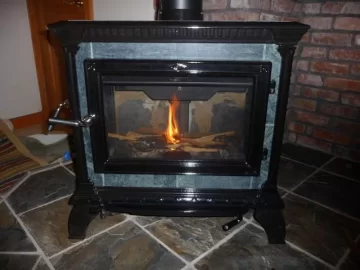

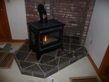

Finished up my hearth over the last few weekends, took delivery this afternoon, and just finished up my first break-in fire. The single-wall stovepipe got up to 150, and stone stayed warm, not hot, to the touch, so I think it went well. I saw a little bit of water pooling up in the side-door framing when I opened it up, so the break-in fire was doing its job. Itching to get this thing going full blast, but held off the gas for the first break-in fire. Couple more ramp-up fires, and we'll be good to go!

Looks like the black enamel. I wish I had gotten that color enamel finish since the matte black I have, which I think looks great when new, has faded into a dingy grey.
You have a unique angle to the install. Should make the excellent side door even more usable.
First thing you need to do is put the proper meter on the stove top. Your owner's manual specifies how and where to monitor the temperature and it is not on the pipe. These stoves have pretty critical temperature requirements that you'll want to repect to maintain your warranty.
It sure looks good with single wall pipe. The double wall that I have hides a lot of the collar.
Thanks Highbeam. I do like the black enamel, but it sure was pricey. I was pretty close to going with the matte too. We'll see if I feel whether it was worth it a couple years down the line, when there are certain to be a few chips in it.
The angle was a real pain in the rear. The location is non-ideal, but I wanted the stove to be visible from our kitchen, and also leave room in the alcove for some wood storage. Also, the flue entry comes through at a really shallow angle wrt the brick face. I actually wanted the double wall pipe. I haven't got the clearance I want to the wall on the left, but the double wall pipe wouldn't agree with the angles. I need to either figure out a way to do double wall, or come up with shielding soon.
Thanks for the tip on the thermometer. It's magnetic, and the guy who helped with the delivery and install said to slap it on the stovepipe, so that's what I did. I just used my hand on the stone for the break-in, but I'll leave the thermometer on the stone for later burns.
I have the brown enamel. only place i really buggered it up was a few hot embers resting on the side door ash-lip. otherwise it's a pretty durable finish. Nice install and welcome to the Hearth! :)

Had my first "real" fire last night. I let the stone get up to about 275 or so for 2-3 hours before damping it down to 1/4 open before bedtime, going through a couple medium sized splits. There was a bit of out-gassing, but the fumes weren't too bad. The soapstone is great...the stove was still fairly warm in the morning, even though the fire was just embers 7 hours earlier.
The secondary combustion is just beautiful...I got all excited about it, and dragged the wife over to look, and she just says "Yeah, I guess it's nice." She just doesn't get me ;).

On that single wall to left wall clearance issue. It looks like the wall is within the clearance for single wall, but, you measure that clearance perpendicular to the pipe so since the crock looks almost perp to the face of that wall, you have mucho clearance and maybe no need for shielding.
