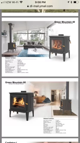

See pic I guess the soapstone is inside?

I'm not sure why you'd intentionally sabotage a perfectly good wood stove by putting soapstone in (or on) it, but to each their own.... that stove looks like it's made of steel, which is is a vastly better thermal conductor.

Not all of the hearthstone stoves are made of stone. It sure is a pretty material when it’s all polished up.

Several companies offer soapstone inside or on a steel or cast stove including Hearthstone, Woodstock, PE, etc. It can be good for heat absorption and slow release where an intensely radiant stove is not required.

It’s a cast iron stove with no ashpan. It also is designed with an inherent flaw. The 2 steel cats are positioned vertically directly below the flue collar. These will constantly be plugging with ash! Not a good move..

That's too bad, at 1.3 cu ft this could be a nice little cabin and small area heater.

I asked a Hearthstone tech how much a set of cats will be, he said the price hasn’t been made available yet.
Maybe hearthstone is getting into the cat manufacturing business....or making a deal with a specific player. Wouldn't be surprised if its proprietary.

When you say vertical do you mean flat like an IS or upright like a bk? Right below the flue collar!
Just reminds me of the cheesy cats added back at the beginning of epa regs as a bandaid.

With the cells vertical.

Right below the flue collar, as in the cat exhausts directly into the flue?? That really defeats the point of having a cat.
Depends on what the point is. For this design, I suspect it was to pass an emissions test.
Very little value placed on efficiency, durability, etc. just like 1990.

Lots of judgement on a stove not tried yet. Efficiency is the same as the BK Ashford 20.1 and Ashford 20.2 @77%. Looks like this is a hybrid design for secondary combustion under the baffle prior to the cat.

I saw it burning and looked over a display really closely. The cat is going to be an issue. It won’t fall apart, since it’s steel. It will constantly be clogging for a certainty. Like other hybrids, the cat is just being used as a scrubber to meet emissions.
