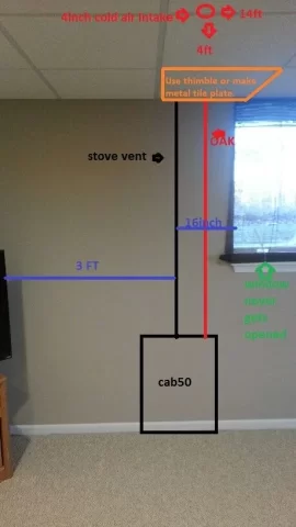

Might be helpful if you draw floor plan or take pictures of proposed locations (ex, stairwell up for air circulation). Suggested OAK length is long. Are there elbows involved too? EVL calculation would show if you have to increase diameter. Pellet vent the same length? You can get thimbles with OAK attached, pipe with OAK integrated but they cost more...
I have a location already picked out and it looks good from the install directions I was reading. The furnace is in the utility room and that would be a bad location for the stove.
If I hook the OAK up to the exsiting fresh air intake it would have one elbow in it. I have seen directions say a OAK is not needed but recommended? A all in one vent and OAK sounds nice.
The spot I have picked is out of the way and not to far from the stairway the goes upstairs. I am lucky my stairway is open and in the middle of the house. I also picked this spot because it is close to a cold air return, if I don't naturally get enough warm air upstairs I will build a duct on the cold air return with a 400cfm fan. I have a cold air return in every room of the house. The outside vent would be safe and clear from trees and landscaping.

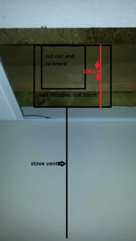

I am not sure how the install will work out. Not sure if I can do what I was thinking. Hope I don't confuse anyone, I have confused my self a time or two. ;lol
I have not looked but maybe there is a thimble that is only 10x10 inchs.

What is behind your drywall about 3-4 ft. up? Is this a lower level / basement with poured concrete walls? What do you have in mind to "re-brace" the floor joist you are taking a huge chunk out of. You would need two posts coming down from what I see in your photo. Not real feasible.
If it is concrete you are trying to avoid you could get a concrete cutting and coring company to come out and bore a nice clean hole. I use guys like this frequently. What you are talking about whacking out is a structural joist. I would look for alternatives myself.
What is your wall construction from your window sill up?
Yes this is lower level. I would not have to take out the whole floor joist. From the install directions from the cab50 I only need 2inch clearance for the vent pipe.
Above that window is the same thing sub floor.
behind all the drywall is poured concrete. I am trying to avoid going through that.
You should talk with the local building official to define your options (keeps the insurance company happy too). Bags is right, for the small amount of extra money, it would be worth it not to mess with the important structural framing members.
It wouldn't hurt to get a coring company out to look and give you a bid or price to go thru the concrete wall. It is easier than you think and would eliminate other issues. If you cut the upper or lower 2 inches of that joist it will kill the strength of it. If you look that is why most holes for wiring and plumbing are or should be in the middle third of the boards.
Most of these concrete sawing and boring co's have multiple ways to bore or cut with. They have chainsaws that cut concrete also. I have used one more than once. Whatever they use normally they hook it to a garden hose for water to lube the cut and reduce the diamond blade, chain, or coring bit wear.
You could possibly do what you are speaking of but would need to thru bolt some plate steel across that area. It would need to be fairly long maybe 4-6 feet or so. They could make something up at a fab shop with bolt holes already punched out in the steel. You need to figure load calculations for whatever that joist is carrying. Looks like it is just the floor above. Any walls right above it?
There are no walls above. How big is a thimble hole? I wounder if I could put a hole in the middle of the joist and use a thimble. I would still have enough room to run a 2x4 full length of the joist top and bottom.
