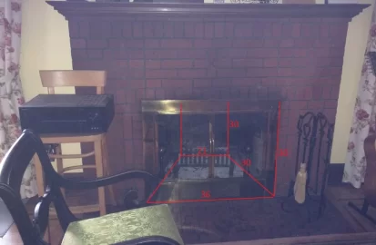

Thank you all for this wonderful forum, with all the information I found, I'm looking to diy install a fireplace insert into my living room fireplace, exterior brick chimney. Looking to heat as much space as possible - but going with insert due to looks, hearth size and wife/new baby.
Looking for recommendations for local chimney sweeps, showrooms, vendors for liner and inserts. I am in Long Island NY
There are a few used inserts on craigslist, and i've read good things about Jotul and the Princess models. I want to lean away from cat models.

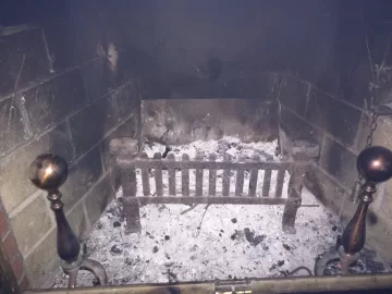

Dimensions are in photo attached. I'm also looking to insulate a liner and blockoff plate and stick some insulation around the insert as well to direct as much heat into the room as possible.
My hope is that the insert will heat up the 1st floor pretty good and provide supplemental heat as well as enjoyment for the family without the issues that the traditional fireplace has, since we do use it often in the winter. More heat the better!

Welcome to the forum! Several Long Islander regulars, here.
The Princess is one of the best stoves on the market, but it is a cat stove. We have many members come here, with an initial aversion to catalytic stoves, only to switch to one after a few years on this forum. You don’t see many folks going the other way, catalytic to non-cat, though. Not trying to sway you one way or another, there are merits to both technologies, but catalytic stoves have several superior performance traits.
The Jotul could work to, but be sure you understand the pros and cons of each, before jumping to any conclusions.
Reactions: Jan Pijpelink
That's a deep fireplace. There is a whole world of options. Tell us more about the house, its size, floorplan, number of stories, etc. so we can advise better. Regardless of choice, a modern stove is going to need fully seasoned wood. At this time of year dry wood can be very hard to come by.
Member @Dix has a mid-sized PE insert keeping her icy hollow home warm on LI. What is the budget for chimney liner and stove?

Thanks for the input regarding cats - i dont know the pros and cons of cat vs non cat, I'm basing my choices on complexity of the unit (future repair and maintenance) and my experience with cats in cars.
I am looking at a budget of $2-$3k. I found a jotul 450 on CL for around that price and my wife likes the look.

How open is the kitchen area and entryway to the living room?
It sounds like you will be burning mostly nights and weekends. If that's correct you will need at least a cord of wood. The C450 is a decent insert medium sized insert and should warm up the living and kitchen rooms fine. If not correct and the goal is to heat more and 24/7 then you should be looking for a lot more wood and the largest insert that will fit.

There's a C450 for $2500 used on CL in my area. Wife likes the look. If a larger unit than the 450 fits, is it worth the upgrade for my needs?
The 550 gets a lot of coverage on these forums (and i read the entire thread with the gentleman who was having issues w/ it).
The C450 price seems high for a used unit. It is quite new?
