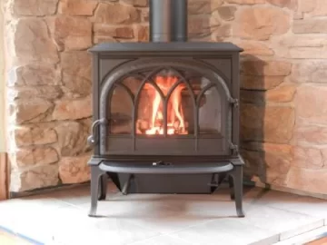

Would it be possible to see some pics of the room and stove setup?
Curious minds want to know......besides, the mantra around here is "w/o pics, it didn't happen".;lol
Oh it's happening;)

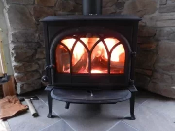

Fired up stove today - again running again tonight - piano lessons.
Got it up to temp. on oak and sycamore easily.
First piece of Sycamore I have tried - it's been split 1 year - seems to burn well.
Once hand held laser got over 600 and blanked out look at magnetic temp. gauge and it was at 700 degs. I then knocked air down all the way.
Virtually no soot on glass.

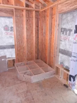

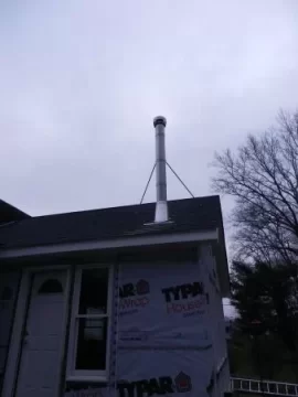

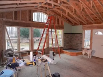

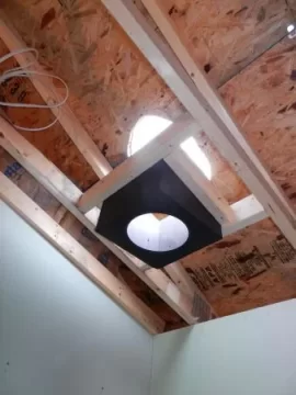

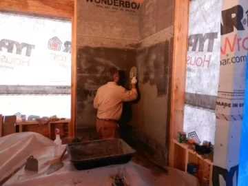

Today's burn on Sycamore

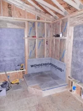

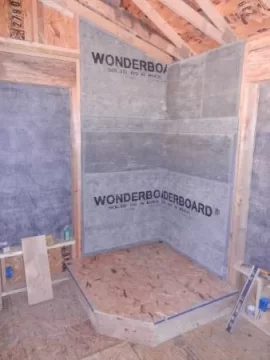

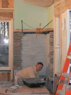

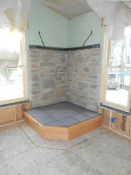

Plan to mount a nice piece of Oak for mantle on each wall and meeting in center.
Had a Cousin make some blacksmith brackets to hold up.
THat's the next step with hearth area.
The photo of the room is showing about 1/2 of the room.
It's a 24' X24' room with a vaulted 12' high ceiling.
Planning on doing some type of tonue and groove ceiling - thinking cedar.

What a great looking stove!! Looks just like mine!!
Great install and hearth, I have a rear vented stove so do not have the chimney going up into the ceiling, worn how much heat that gives additional to the stove?
Wow Gabby, really nice.
I love the windows too. I guess you don't mess around when we say pics or it didn't happen.;)
Nothing like proving a point.;lol
Are you a stone Mason? Looks like you and Scotty should work together.
I think you are good to go, you won't really know until you load that puppy up go through a full cycle down to coals, reload and run it again. Good looking addition that the stove will fit well in.

Nice that your dad is there to see all that happening.

As I was adding some kindlin I noticed the cast inside the stove started to sweat.
This time I left the door a jar longer (per advice above) to really get things going and then I noticed the inside of the glass is sweating too.
Now keep in mind the soot I have had on my glass won't even come off with your finger nail - when using newspaper/water/ash method it is coming off but not without some decent scrubbing.
So this time when lighting I left the door open until all the condensation dried off of the glass and then shut the door.
Although there was still some smoke inside the stove as the kindlin was taking off, this time it wasn't sticking to the inside of the glass.
Before if I had smoke at start up I had soot build up on glass that would not come off by just touching it - it was baked in.
I kept the fire going a while while I was outside doing some siding and kept checking - no soot on glass.
Due to having to leave for Scouts I didn't want to add a nice piece of wood so I added a pretty bad/rotten piece I had laying around and with playing with the siding and not paying close attention to the stove the fire did start to smolder BUT this time the little bit of brownish soot I had on the glass I could pretty easily wipe off with my finger.
I have the same stove... have had it now for about 12 years, and I feel like it's taken me quite some time to figure out how to get it working really well.
Any kind of moisture in the wood will show up as condensation on the glass when starting it up, and that damp smoke will eventually turn brown if the stove isn't brought up to temperature (400 - 600F) quickly. It will eventually burn off, when the stove is > 500F.
Also, even when the stove is up to temperature, and some wood is thrown in that's not totally dry / seasoned and takes a bit to fully catch, that wood will throw off smoke than can stain the glass, especially if the splits are loaded N-S (ends facing glass and back). If the end of a piece of wood is giving off moisture close to the glass, it WILL turn brown, even if you're stove is between 400 - 500... but again, it will eventually burn off.
If the stove is hot and I'm putting in wood that I know may be less than ideal, I'll open up the damper a bit and not close it down until the recently added wood is REALLY burning well. One mistake I used to make was putting in wood when the stove was hot, and thinking I never needed to adjust the damper because the stove would be hot enough to get it going. That's true if the wood is dry, but if it's at all damp, it helps a lot to put more air in for a bit until the new piece is burning well. Otherwise, some smouldering and dirty glass.
Had a long burn yestyerday while I was out finishing putting up siding.
Had a few short after work burns during the week as well.
With now leaving the stove door open longer until condensate dries and then closing I have virtural have had no problems with soot build up on door glass and the little that I have had I was able to wipe off easly with a dry newspaper - flaked right off.
Seems the condensat was the issue.
I would think once I get the room insulated I won't be starting the stove with it being so cold (yesterday the stove was 32 degs. at start up).
But if I do, and now knowing to look for condensate, I don't think I will have any issues.
So to answer your question of "how's it buring".......great.:)
