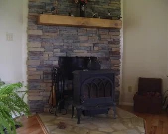

I'm too lazy to read all of the replies but here is what my 400 looks like. It is a little beyond recommended clearances and the stovepipe runs into the T. The chimney is inside the house and runs up behind our faux fireplace. And it works well and has very little creosote.

Nice install shineyhaid! Welcome.

Nice looking install shineyhaid. It looks like your chimney was quite a bit more complicated than mine.

Nice install! I like the extra hearth area for the wood cradle!
Thanks, I'm really glad I added that little extension, it filled the space in the middle of the wall much better that way. I have also had my eye on one of those hearth centers that Pilgrim sells because it would fit there perfectly and match the stove better. They are a little pricey though and my local dealer doesn't keep one in stock so I would have to order it site un seen and I hate doing that.
