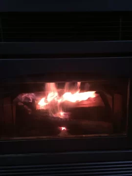

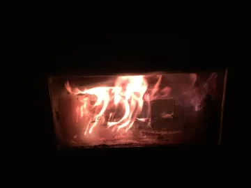

The only time i give it air is when I open the door or new fire. In that case it is only open for less than 5 min. Stove door temp when full of wood burning is around 400-450. Like should it be flaming like this with draft closed? It was under control but now it’s flaming up again.

It sounds like you are doing everything correct. Double check the door gasket, and use bigger splits.
I found that blocking off most of the air intakes, as well as putting a piece of formed sheet metal with a magnet over the one remaining (so the hole can be adjusted) really helped with the controlability on my insert with a high chimney. It's a whole 'nother stove.
Your mileage may vary.
It sounds like you're getting too much air. Either from leaks, which is doubtful if new, but check gaskets anyway, and check your air mechanism. Some when they are "closed" still allow some air so you can't starve a fire, which may be fine with an average chimney but can be too much air for a tall chimney with a strong draft.
