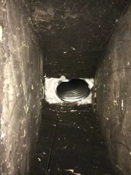

My son is concerned about exposed insulation around a flex liner install in his chimney. He is wondering if it is safe to burn wood in the fireplace. Attached is a picture:

No it is not right that needs to be covered with masonry or metal. Also what size liner is that it looks really small for a fireplace.
