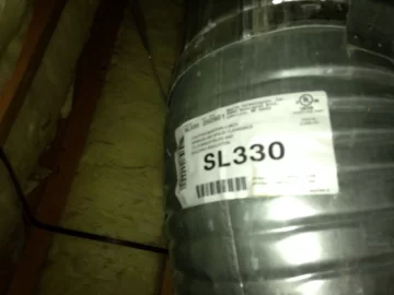

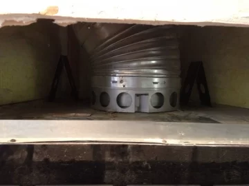

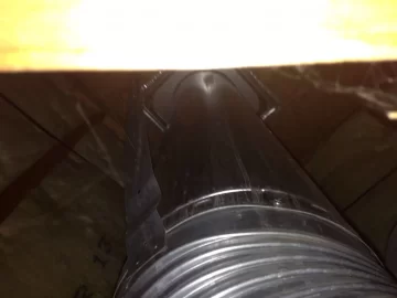

I just got to thinking. Is there any EPA fireplaces that would mount to my existing chinney? I attached a photo.
Another photo.
One more.

Not to my knowledge. You will need pipe thats rated for the higher temps of a stove.
Just for information purposes , the reason you need a new chimney is because that sl330 is only rated to 1,500F. You need a 2,100F rating which will come from the class a pipe.
Another possible option would be to extend the hearth and put a freestanding rear-vent stove on it connected to a stainless steel liner up the ZC chimney. This would depend on the height of the lintel on the fireplace relative to the floor because it would need to clear the rear vent flue collar height.
