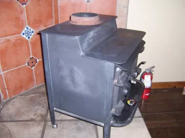

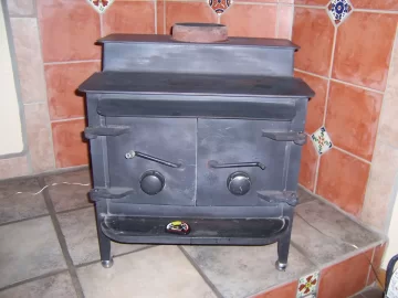

Thanks, I believe a lot of my problems were due to the original installation. Male (crimped) ends were installed facing up and all the joints were bent by pliers during installation. They had leaked like a sieve and I finally wrapped them last winter with metal duct tape. Also the previous owner had been cleaning only the top 80% of the stove pipe. This was very evident when I removed the old pipe yesterday. Obviously I'll be installing my pipe with the crimped ends facing down. Now with the stove. Attached are 2 photos of it. One big question I have is do I need a damper in the stove pipe since both doors have adjustable openings for air flow? Also the lady at the local wood stove store thought the stove might be Consolidated Dutchwest. I've spent several hours on the net and have yet to find one similar to ours. Any help would be appreciated. Thanks!

Interesting looking stove, haven’t seen one like it before
Are the surrounding walls around the hearth all adobe, all the way through with no wood? Yes, you will probably want to have a stove pipe damper about 18" above the stove. What does it look like inside? Are there firebrick and a baffle?
I see lots of probable clearance issues there.

What is behind that tile? Is there a ventilated air space or is it right on combustible material? Without a ventilated air space you are not fine. It is dangerous
It may feel fine, but code requires 36" clearances in all directions for an unlisted stove. That can be reduced with proper wall shielding, but a simple tile wall is not a proper shield.

Your stove looks like a locally made copy of a Fisher or Alaska double door stove. Yes you need a damper.
