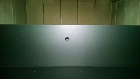

Just had a Canyon ST 310 installed and I am stumped by the small hole located below the door. This hole is open into the stove and not covered by the door gasket. What is its purpose and will it not allow the stove to be "shut down" due to the constant flow of air towards the bottom of the fire?

Welcome. I'm not sure about the hole, it may be boost air to aid fire starting. What does your dealer say? Note that this is not an airtight stove in the sense that closing down the air control shuts off all air. No EPA stove is. Even with the air closed off the secondary manifold is unregulated other than by the holes in the manifold.
I agree on the poor manual. Here is a picture of the hole. [Hearth.com] new owner of a Canyon ST310 .
I would guess its boost air for easier fire starting. That usually is not documented in the manual.
