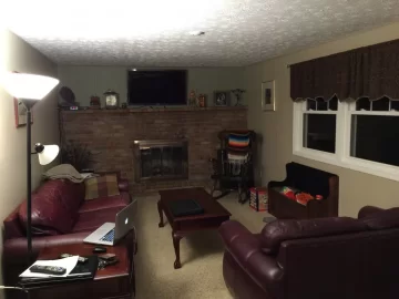

Pop us a picture of the new fireplace location. I not convinced about the aesthetic issue yet. The Equinox is a good looking rock.

Attached is the photo of the new area / fireplace. Green, I should have used the terms, limited space. This area is long and narrow. The family room, dinette, and kitchen are all together and open in floor plan. The equinox would no doubt for its appearance be just fine, but its size is what is really in question, not its aesthetics. That wasn't the proper term. I should have explained that it was a size to room ratio rather than that. Bart, I want to exhaust all options before the next steps. Doug, I think the stain burned out. I was so thrilled at how easy the stove was compared to the Dutchwest I forgot about the stain! I I could tuck the stove back in the fireplace hole that would be ideal, but not sure if that is the best practice here. I don't plan to heat the whole home with this stove, occasional efficient burns is what I have in mind but that could change, if it will work at all.

Got it, the picture helps a lot. Sell the Equinox for the same $ or a slight profit. Then buy an insert for the fireplace.
Have to agree with begreen, I can't see an Equinox fitting in that area and if you did, you'd be cooked out of that room. I will qualify this by saying that my Equinox has yet to burn in my house, still working on the stone work. The room for my Equinox is about 1000 sq ft. but also avg. more than 12' in height. plus open plan into the kitchen area.
