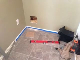

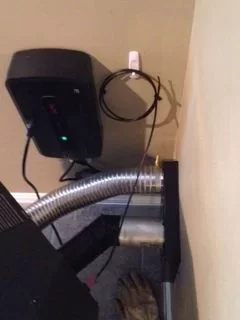

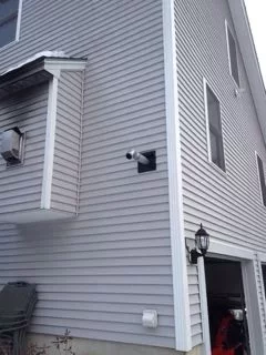

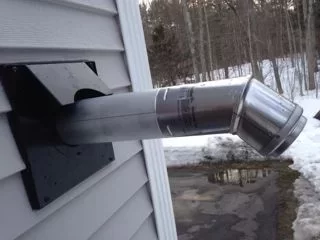

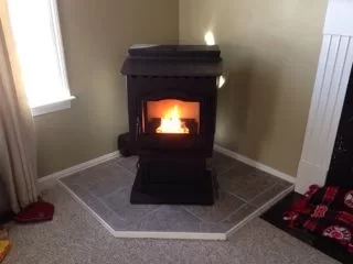

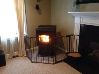

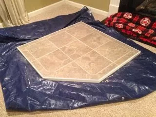

Just finished installing my new Toy- a P61A purchased from Hearth Designs in Hooksett, NH. Built the hearth pad myself with 3/4" plywood, 1/2" cement board and some leftover tile from our bathroom floor. Using the Harman OAK and APC BE750G UPS. It has done a good job so far of keeping our 2500 sqft colonial warm, though it hasn't been very cold. Using an Ambient Weather WS-10 wireless digital thermometer to monitor the temp in the bedrooms. So far maintaining a 4-6 degree difference between first and second floors. My wife is sick of listening to me talk about how excited I am with it so I thought I'd post some pics of my baby to brag a little...(broken image removed) [Hearth.com] New P61A install[Hearth.com] New P61A install[Hearth.com] New P61A install[Hearth.com] New P61A install[Hearth.com] New P61A install[Hearth.com] New P61A install[Hearth.com] New P61A install

Great looking setup with your UPS I assume......you should run a few power out tests with and without the ups to see how your exhaust handles it, as you might find that without any rise on the exhaust there may be some smoke backing up into the stove.....if it happes the fix is easy enough, just add 3 - 5 ft of vertical.

Nice looking install and nice home. I'm heating a colonial, a little over 2000 sq ft and the p61 has done her job without breaking a sweat. Keep her clean and feed her and she'll treat ya good.
I would move that room temp up off the floor to get a more accurate room temp. I have a corner install also. I put at hopper height in the corner.

Perfect fit, the P61 and that sq footage makes sense ! Looks good in there. I had considered a side of the fireplace install as well but the wife wanted no part of it. I too would suggest a little vertical rise in the vent but you may find it works fine as is ( easy to clean if nothing else).

If he has the oak installed, as stated, smoke in house should not be a problem with no vertical run, as the oak creates what should be a sealed loop.
Very nice install,nice stove.For brewer-most stoves are not "sealed' most have openings for glass air wash,which is why a lot of people reccomend a short vertical.
ab
For bob bare: harman products are typically sealed up tight as a drum.....even the air wash....just sayin
Hoping the UPS will take care of smoke in the event of a power outage. Just need it long enough to get the generator running . . .
