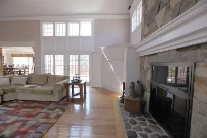

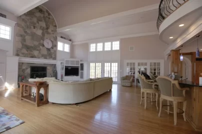

I am not sure for clearances. I may have to use a hearth-extension pad. The sides should be ok. The height seems like plenty and the F600 has top or rear exhaust so it seems flexible. Maybe if the stove ends up pushed into the fireplace I would lose access to the side door? Or maybe not. No one says I have to center it. I can't measure it yet - this is a new house and the closing didn't happen yet.
I would have that F600 in that beautiful room in a heartbeat.

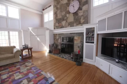

Another complexity - I need 30 inches between the stove and the mantel. I don't have measurements to know if that would work with the PH and 10 inch legs.
Removing the mantel may work out ok, depending on if the stone looks normal behind it or not. It looks kinda dumb anyway, and putting a strip of wood across the stone face of your fireplace doesn't seem to be a good idea.
That is the highest mantel I have ever seen in my life. By a factor of at least two. If that sucker ain't legal with a stove under it then we need to to shut the site down because every fireplace mounted stove here is illegal. The mantel is close to the distance from my stove top to the ceiling.

If you align things visually, the top of the mantel is the exact same height as the top of the doors to the deck. That would mean that the top of the mantel is 80 inches high.
The stove is 33.5 high. The stove plus 30 inches of required clearance is then 63.5 inches high. So this is legal as long as the mantel is less than 80 - 63.5 inches tall. That is 16.5 inches. The mantel could be more than 16.5.
It is possible that there would not be 30 inches between the top of the stove and the mantel.
What are the odds that the stony masonry is continuos under the mantel and I can just remove it and have the stone look normal?
