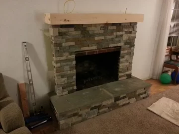

In process of refacing. We used Airstone from Lowe’s, it was really easy to use. Basically just glue and stick.I also had to extend the height so that the mantle would meet the minimum clearance height. I used a non-combustible ceramic board for that.
Almost there, with new mantle. I used 1x12s for the top and bottom and a 1x6 for the front to make a box section. There are two electrical outlets installed on the top surface.
