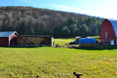

HI, the wood rack on the left was an cow feeder I think, I raised the roof and used the concrete blocks, to support the roof works so far
  • [Hearth.com] New seasoning shed...install
