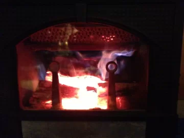

    I know the view from my cat stove - a Woodstock Keystone is terrible... :)
    Woodstock Keystone 01.jpg Woodstock Keystone 02.jpg Woodstock Keystone 03.jpg

    Cat stoves are ok with the air cranked up. I just think its fair to inform people that if they are after a great fire view, cats don't usually give the best show or have the cleanest glass around when the are ran slow, like most people would want to.
    They are great and all, but the hybrids have a great view, clean glass, even on low, and respectable burn times. Kinda the best of both worlds. IMHO

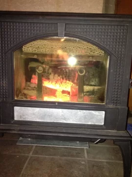

    Mine never does that. It fills with gas and ignites later in the burn, like in my picture, but I can't hear it at all. If this happening early in the burn then it means they are restricting the air way too soon. The primary air should be wide open on a reload, if its puffing right from the start, they need to open the air up.
