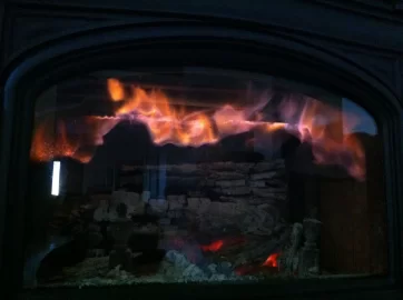

If you want a nice fire view, steer clear of Cat stoves as well, some are better than others. But, for the most part the fire isn't as pretty as secondary tube stoves. If you want an especially nice fire view go Hybrid! >>
Yea, carefull with the generalized statement to "steer clear of Cat's...", my and your Hybrid stoves have CAT's, yet have a beatiful visual burn. That pic you posted is a classic, georgious shot! I've got similar shots from my PH this winter, and I know the pic never does the real life flames justice, so it probably looked even better in person.

Mine has never "backpuffed". I get flare ups, it's awesome to watch but it never smokes or puffs out. I don't have a very tall chimney or the best draft really. In late winter I had a slight smoke smell and it didn't seem to be burning good on low, turns the cat was partially clogged with ash, vacuumed it off and no problems. Maybe these other stoves had the same thing going on?
My Leyden would "puff", it would blow the top lid open and fill the room with smoke!;sick I'm glad it's gone!
Here is a pic of a nice flare up!
Flare up is a better word for it. I say "puff!" cause it makes that sound from inside the stove sometimes, but I'm not referring to actual smoke being blown out, just the sound. The pic you posted is not what I'm referring to, that is way to far along in a burn for this to occur. What I'm referring to is at the very beginning of a reload, you have very little hot coals in the bottom and you reload a full load. So you have nop flames, just a very light smoldering burn at the bottom where the new wood is laying on the hot coals. Enough gas builds up from the outgassing new wood, and "puuuuuffff", the entire stove lights up/fills with flames for about 5 seconds until all that gas is burned off...and then it goes black again.
