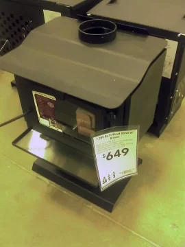

Took a pic of it last week and forgot to post, here is the one they have at my local Lowes.

That's the one at mine also. IMO, it looks like a good stove, but really small inside. I'd like to look at larger versions.
Matt

Here is the larger version for $999 at Lowes. After a closer inspection I wasn't impressed with the way the handle is attached or the how cheap the feet are. It does have a very large firebox and door opening. The $899 stove at Tractor Supply is much nicer but the door opening is kind of small which seemed strange.
