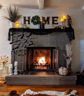

We moved into our new home a few months ago and we finally have a beautiful fireplace! I had no idea how inefficient they actually were and was silly enough to think it would do a good job at heating our home this coming winter.

This is our fireplace now

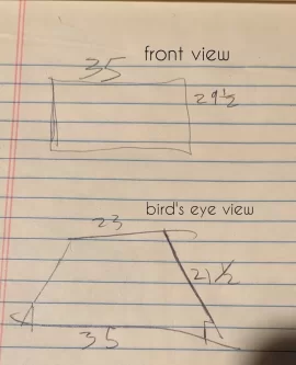

Here are the measurements of the fireplace

I think a 2 cu ft insert will suffice given the constraints. Without fan circulation an insert could overheat the 252 sq ft room due to the restrictive doorways. It will be easier to see this once the floor plan is posted. Are the doorways 3' openings or larger?

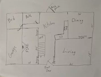

Here is the layout. We will eventually be removing a partial wall making the doorway from the fireplace room into the kitchen just about double in size, but that won't be until the spring/summer. We do have a ceiling fan in the fireplace room as well.
I think the biggest issue that we'll have is getting the heat to the downstairs back bedroom, but hopefully with correct fan placement, it won't get too cold back there.

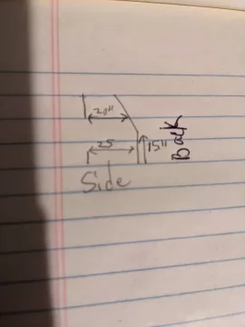

Folks may also ask for following dimesions: (1) height in rear of fireplace if less than front opening, and (2) depth measuring perpendicular to rear.
Height in the rear before the slope is 15"
Depth at the top (front to back) is 20
Depth at bottom (front to back) is 25"
This is the side view

How is electric heat set up? How many thermostats are there? Could give thought to using insert to heat a portion of the house and let electric be supplemental for the rear bedroom you mentioned.
Each room has its own thermostat and baseboard electric heater. We will supplement as needed, but we'll definitely try using fans to disperse the heat first

That helps a lot. It will be a challenge, the 3' doorways are the issue. As a test, I would start out with a box fan or 12" table fan, placed on the floor, in the livingroom doorway, blowing cool air into the fireplace room across the entry hallway. That should help pull air in behind the fan in a convective loop, through the kitchen doorway and back to the livingroom via the dining room. This will help cool down the fireplace room while distributing the heat.
