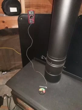

(Apparently the woman thinks I'm paranoid because) I bought a stovetop thermometer that sits on the top of the stove just in front of the outlet pipe, and I'm using a multimeter with a thermometer probe as a backup. Interestingly the multimeter will show ~450, where the stovetop thermometer shows ~650... so I'm assuming that the multimeter is correct, and using the magnetic stovetop thermometer for a basis of how the fire is doing (getting hotter, colder, etc) instead of for an actual temperature.

I am using an internal probe thermometer inside my double wall flue, I by far prefer this to a stove top thermometer as it is more accurate,
With a normal wood load for my stove the flue thermometer will top out at between 550° to 600° for 20-30 minutes depending on the flavor of wood in the firebox at that time then slowly starts edging down for several hours. I have seen it for short periods way up past 700° several times.

Out of the 3 or 4 flue probe thermometers I purchased the Condar Fluegard is the absolute best of them all, it will last a lifetime and its made in North Carolina.
Very very simple to install, follow the instructions included with the thermometer its easy peasy, you drill a hole straight in through the double wall or single wall flue pipe, was it a 1/8'' or 3/16'' diameter hole, I forget now, either way its a very small hole and real simple to install.

On another note, modulating with tinfoil does work to tone down the fire FAR faster than closing the damper. Working with a buddy who owns a machine shop to figure out a solution.
Also ordered the flue temp gauge! Thanks guys.
