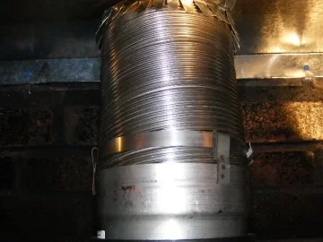

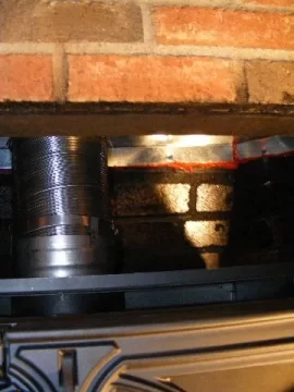

So, I pulled the cover and found the following: Fan cord dislodged. Fixed, no probelm. However....the old outside air supply wasn't properly sealed off. I stuffed a rag in from the outside and that slowed the air inside down a bit. The next surprise was when I looked up at the "block plate" and saw a three-piece "plate" with a big gap/hole in it and no isulation or sealant. I also noticed that the liner insulation wrap is about 12-18" short of the block plate....yup the gap waws big enough that I could clearly see a little way up the chimney. The edges of the chimney cap at the top of the chimney looks a little rough too...and since there is a bit of a draft I am guessing that it isn't really sealed well. So, I am writing a letter, and I guess stopping the check until it is fixed. A little nerve-racking and very dissapointing. If I can get pics up I will. What fun....and it only cost me $775!
Attached two pics of block plate. Read through my manual. It states that the block plate should be sealed and the air space between the liner and the chimney should be able to vent at the top. I am unsure of what they did at the top. I will have to go up and see. (Snow and ice on roof and my schedule is preventing being home before 9:30 PM. I will try and get the photos posted correctly.
  • [Hearth.com] New to wood burning, this forum, and about to buy and insert...hello and please help.
Doug, That is some seriously sh*tty workmanship on the blockoff plate. I do not think that anyone on this board who is a qualified installer (I am not) would call this a professional job. It looks like they just layed some scrap pieces of sheet metal on top of the damper throat. The one I did for a buddy last Saturday looked similar to mine but we did it in two sections and seamed it in the middle. It was a little more time consuming to do but worked better for where his liner cam through. The whole thing took no more than an hour at most to measure, template with cardboard, fabricate and install.There are many examples on this forum of good ones done many different ways but that is definitely not one of them. Here are the only pictures of mine that I have for reference, it is not as good as the last ones I have done for friends. Good luck, Jim

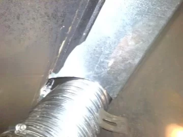

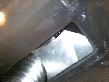

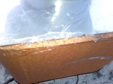

so this got even more intersting. I went on the roof when the snow melted and found this treasure. (There are more pics, but I think you got the idea) BTW, thanks so much for the block plate picts. I will look at some more pics. I have two questions yet... is it ok to have the flue sealed up at the chimney top and sealed tight at the block plate? Also, should there be high temp insulation stuffed in and around just above or on top of the block plate?
Doug, The whole job looks shoddy. To answere your questions, yes I have both a top and a bottom block off. And I did pack rock wool fire stop insulation around the pipe at the top under the top cap and in the damper area above the block off plate, it seems to work real well.
Doug, I can't believe the poor workmanship of the whole job. My first impression is to photograph their work and post it all over town. Hopefully , they didn't cash your check, but I'll bet they ran right to the bank with it. I bought a chimney cap from Chimney Liner Depot? on line . It fits a 12 x 12 flue and it is easy to self install. I will e-mail you some photos of how I keep ashes from spilling outside the stove. Hope you are fimally getting some heat from your 550. Warren
Doug, Look at the 6 inch deluxe terra cotta flue plate for 13 x 13 tile at Chimneylinerdepot.com It nounts with only four screws and hold up in very high wind, where I live. You probably have a 6 inch flex liner. ;-) Warren
