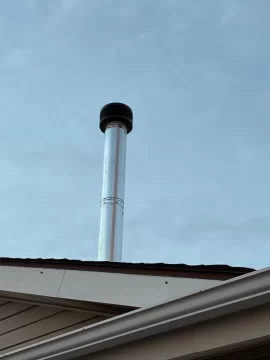

Is this normal for new pipes? Just from creosote from not seasoned wood?

Watch the cap screen for plugging. A clogged cap does seem to happen more with new installs. This may be due to a few reasons.
The screen is too fine
Wood is poorly seasoned
The stove is not being operated correctly
Also, the chimney pipe may need a brace if it is over 5ft tall. How tall is this chimney above the roof?
That black is uniform across the whole cap, even the underside. Is it possible that it's just painted? The screen does look a bit sooty though.
If you have the ability to go up on the roof and check the cap and take a better picture that would help you out some.
What stove are you running and what is the moisture content of the wood your burning
I think it's a new install of a Dauntless. A previous posting hinted at a possible chimney fire but there hasn't been any follow-through.
Be green,
Yes you’re correct in that it’s a new Dauntless. But no chimney fire, just a hot pipe while breaking in.
Running a new Dauntless. The wood is freshly cut standing dead with a moisture content of 5-20%.
Thank you for all the info.
it’s not over 5ft but we do have a brace we plan to install just to be safe.
Standing dead firewood can often be high moisture content. It doesn't start drying out thoroughly until split and air dried.
How is the moisture content being tested? On the ends or after resplitting and on the freshly exposed face of the wood?
After resplitting
If you have a pair of binoculars, see if the cap screen is plugging.
Low pitch roof, less than 5ft of chimney. Let’s quit speculating and get up there and check! Might as well separate that pipe at the joint snd get a good idea of what’s happening in there at the same time.
