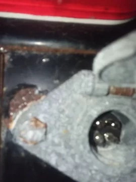

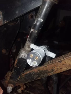

I want to put a winch on the back and forgo the sander. I will take a pic of wiring harness thingamajig to see if anyone can help the process.
I want to hook up red and black wires from a hf winch any suggestions?[Hearth.com] New toy[Hearth.com] New toy
Before doing that check you battery to make sure you have enough amperage to work the winch, secondly buy the other plug end and make up the plug the right way, or take apart the existing plug on the source side and get a test light or meter on it to check your wires, make a tight connection using rated connectors and heat shrink wrap, fold in any other unused wires and cap off the ends so the wires don't get ruined.

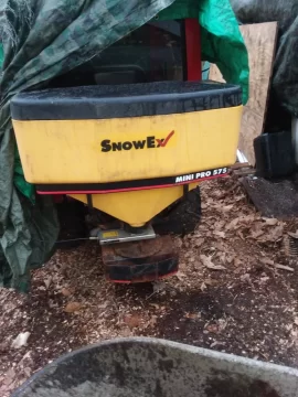

Upon further inspection the 4 way appears to be red and black x2. It is powering 2 seperate electric motors on a snowex mini pro 575. I suspect I have plenty of juice for a small winch.
What is that round plug called?
My hope is that its not proprietary.

That looks like a standard 4 pin trailer plug.
What gauge wire and what size fuse is it using? Winches can put a huge strain on the electrical system. What are the ratings of the potential winch?
I would run a new large power wire for the winchMaybe you can use the old wiring for the winch control.
Every electric winch i have used always comes up against the big load that is to heavy for the winch,but you keep on winching anyway because it is almost there...
Thats when the wires get hot and start to melt.Why risk losing your cool wee widdle loader to a $5.00 piece of wire.
Wire it right and with the proper fuses and relays then you will never have to do it again.

winch- several hundred amps at 12v #4 gauge or better size cable ( lower the # bigger the cable gauge wise). just for an idea a hydraulic plow system on a pickup will draw close to 400 amps.
This style connector is one of the best out there for higher amp draws, and they are available in varying sizes from 50 amps up to several hundred. Frequently used for portable winches, plows, electric forklifts, etc

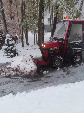

We had 4 inches of slop on top of leaves, rather than spend the day unclogging an impeller I pushed it all away

It's Sooo Cute...()
I want one to hang off the mirror of my 980
