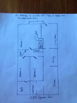

Thanks for everyone's help. This is the floor plan so I guess my first step is to see if you guys think a a stove will heat my house due to my limited open space. The fireplace is double sided. On bedroom one side I have the exact same setup as the original pic but I still have my gas log insert installed. So right now the gas log insert and the black bart are sitting back to back. Gas logs being in bedroom one and black Bart being in the living room. I'm assuming the other gas insert will need to come out for my new project so then u will be able to see through to the other room. Any ideas?

If the gas log fireplace is properly and safely installed it may be able to stay. This will depend on how it is installed and vented. The venting needs to be independent of the new wood stove. How is that unit vented? Whether it remains or not is your call. You may want to pull the gas vented log fireplace and increase closet space in the bedroom.
Thanks for posting the floor plan, that helps a lot. With the removal of the bumpout for the area where the Bart now sits you don't need an alcove. It would be more like a corner install with the closet being one wall of the corner. That will make the install easier. Just rebuild the wall behind the stove making sure this partition honors the gas vented log fireplace clearance requirements.
As far as heating goes, in your milder climate I don't think it will be too hard to heat. A 2 cu ft stove would make a very large difference. You could go for larger but most of the time it would be idling. The main trick will be getting the heat distributed. Does the home have a basement? How large is the opening between the living room and the dining room?
The gas logs are non vented. Just the logs and a box. No I do not have a basement. The opening between living room And dining room is only 36". And the opening between dining room and the hall leading to the bedrooms is 48". Neither have doors, they are just walk through openings. Although my wife won't be happy about it, I will install Whatever fans are necessary to make this work.
Getting the living room warm should be no problem. Getting the heat out of this room and into the rest of the house will be a bit more of a challenge due to the small doorway between it and the rest of the house. Here are some thoughts on possible solutions:

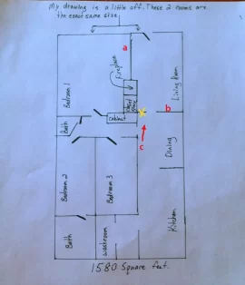

1) Widen the doorway to about 5 ft. by removing the area that ties it to the center wall. (yellow X). If this is done you may be able to just skip to #4 and keep things simple and a bit more affordable.
2) locate an in-wall fan system to pull air out of the bedroom and into the stove room. This will cause warm air to be pulled from the stove room into the bedroom hallway and then into the master bedroom. Tjernlund makes a fan for this purpose called the AirShare. It uses the wall cavity so that you can put an intake grille up high on the bedroom side wall, and the fan down low on the livingroom side. The stud cavity acts as a duct that blocks light and noise spilling in from one room to the other. This would be installed somewhere on the wall labeled "a"
http://www.tjernlund.com/airshare_ventilation.htm
3) put in a second AirShare at location "b" blowing cooler dining room air into the stove room
4) Locate a simple 10-12" table fan on the floor somewhere near letter "c".
he idea is to blow the cooler air down at floor level, toward the stove. Here is the general idea: For more even heat in the house put a table or box fan in a cooler room within sight of the stove room, placed on the floor, pointing toward the woodstove room. Run it on low speed. It will blow the cooler air down low, toward the woodstove. The denser cool air will be replaced with lighter warm air from the stove room. Running this way you should notice at least a 5F increase in the room temp after about 30 minutes running. And the stove room temp should drop by a corresponding 5+ degrees.
