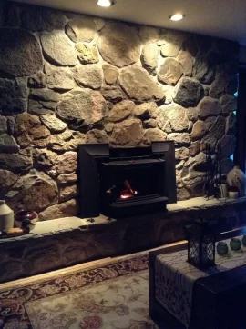

Thanks to all for great tips and advice! Excuse the stove not being fully assembled...still waiting on those missing parts :mad: ;em
So, I don't really know what I should do. If I trust the magnetic temp gauge it reads not even 300. I did cut the air a little (not sure why :p) temp seems to be holding steady. I know I need to bring that up a bit. Should I add more wood and or open up that air or both?
Ahhhh it sure looks pretty and is heating the room nicely.

Personally, I would let it get hotter. How's the smoke coming out of your chimney when you have it running on that low of a temperature??
IMHO, it should burn hotter. It is possible to get a hotter fire with out a full firebox, but this IS your learning curve :)
I can see smoke, it's not a crazy amount of smoke but I do see it. It's been about 30/35 min since cutting the air a little and have added no more wood and the temp I thought was holding DID climb. I'm a bit over 300...looking for hubby's instant read therm now. I'm def going to add more wood. I'm just unsure about when I should be cutting air and or adding more wood.
Take a deep breath, and let it get it at least 500F.
Smoke is not the goal, except on a reload for 15-30 minutes, tops.

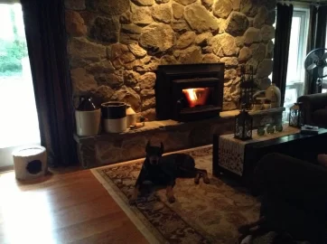

Today my missing parts came! Surround now complete!

That looks nice Fire, I see the dog has staked its spot, its doesn't take them long to find a nice comfy spot near the stove. My dog usually sticks to me like glue, when the stoves running she's in the other room all night in front of the stove, seems to calm her down so its a good thing.
Reactions: Firedancer
Forget the insert, that stoneware is awesome!
Thank you. Believe it or not, that stone is real. Our house was built in the 70's and I have photos of the original owner standing in the driveway surrounded by all those rocks. It's pretty neat.
Another fireplace in the house is brick-they're pretty bricks....long/skinny.
Nice, FD. Love the dog, parked :)
Keep that floor fan handy, you might need it

Nice set up you got there...now it's time for another insert in the other fireplace.....
Won't be needing that with that beast she has installed. Plus sometimes its nice to still have an open fire on those chilly fall nights.
