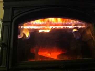

You did good by having 3 break in fires. Other stoves require 3 or 4 getting progressively hotter.
Secondary fires are exciting! So many people out there never experience it, mostly because of their green firewood and poor burning practices.
It's quite a spectacle!

I will save my usual sermon about secondary burn chasing till she has been enjoying the insert for a while. ;lol

Like a kid at Christmas. I'm excited..do I then want to cut the air a bit when it happens? If I understand it, that secondary will really heat up the stove, correct? I think I then cut the air just until that flame gets "lazy"???
The secondary will actually fire better after the air is reduced.
I am the guy that thinks the blasting gas burner looking stuff up top is a parlor trick. Fun to watch but don't over fire your stove just to make it happen. If the stove is over five hundred degrees and no smoke is coming out of the chimney, you have it just right. The secondary air is picking off the stray un-burned gases like it is supposed to and you can see the little "poofs" up by the baffle when it does it.
Of course I am in the minority. Most folks love the light show. >> I did too. For one season.
Yeah. As you close down the primary air control some it shifts the air intake to the secondary air and the unrestricted "EPA hole" intakes. You have a certain amount of draft and air is gonna follow the path of least resistence.
