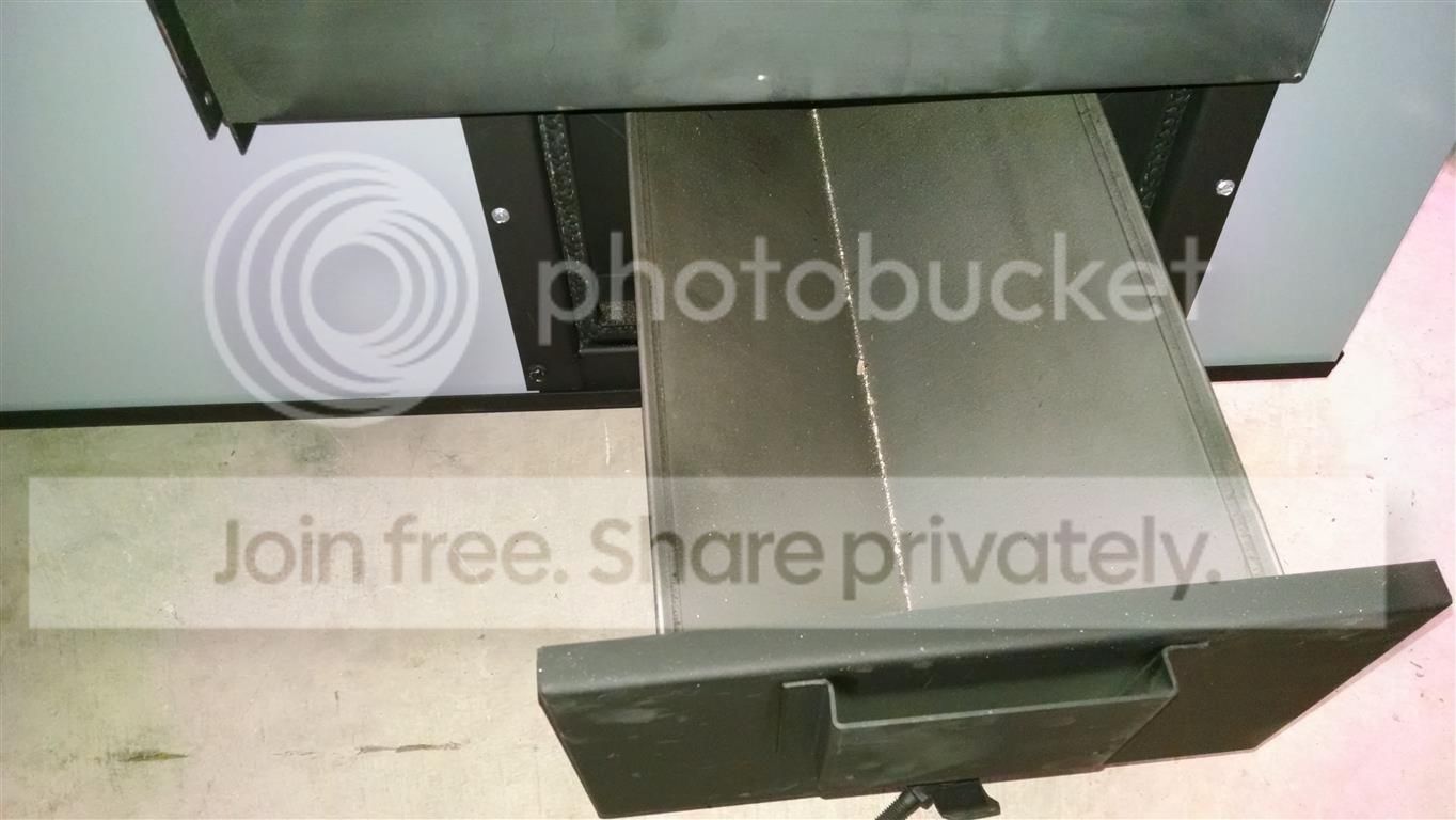

Ash bin(really looking forward to using this==c)
[Hearth.com] New Yukon-Eagle Husky Wood/coal/propane furnace on the way.....

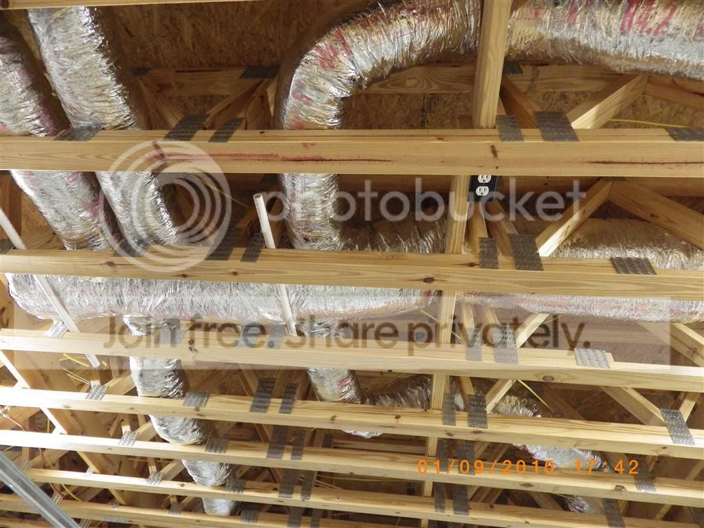

Here are some more pic's of the install and duct work:
