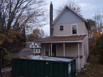

I am hoping for some advice about what to do. I've been involved with burning wood all my life, till I was 15 I lived in a passive solar house with a Fisher wood stove in the basement which did all the supplemental heat. For the last 20 years I have lived in a huge converted barn with a gasification boiler, and there is a house with a DutchWest catalytic stove from about 2002 in it across the way. I just bought an old house in the Adirondacks and am working on it now, planning to move there next year. It's officially 950 square feet, but that is based on the outside dimensions. It was abandoned for 6 years and all the plumbing and the oil boiler and distribution lines were allowed to freeze, so I am starting from scratch about heating. There is a ventless propane heater on one wall but I don't think they're healthy and won't use it.
I'd been thinking of getting a wood stove for the house, and a smaller one for the ~14x32 woodworking shop I need to build in the back yard. However, as I have been looking at the forum here over the last few weeks and reading about the 2020 approved stoves and how they need >20% moisture content wood, I am doubtful. The lot is just under 1/4 acre, so I have limited space to dry wood. For our current boiler and stove I have always cut wood in the spring, stacked it in a shed, and begun burning it in the fall, so my drying times have been 6 months to a year and that has worked fine. Once I move I will not have any dry wood on hand, as the new house is 120 miles away. It sounds from what I am reading here like I would need to buy wood now and stack it to be dry for fall 2023, and in the meantime I would need to heat another way. I am not planning to stay in this new house for more than 5 years, and maybe less. My goal is to build a house somewhere up there, when money permits and I have found a place where I'd like to stay for many years.
I like heating with wood but am also open to other options. I have fairly new 100 amp electric service up there, so I am not inclined to go to the expense of upgrading to 200. I have read a bit about air source heat pumps for cold climates but I have no experience with them, and don't know anyone who has one, and I don't know how much power they take. I have also read about vented propane heaters, and that seems like it could be a viable option. Or maybe there are other things I haven't thought about. I am having trouble finding a way to get a realistic number on how many BTUs of heat I should need for the house. I have seen 5-6 BTUs per square foot given as a rule of thumb, but the building I live in now is 7k+ square feet and solely heated by a 140k BTU wood boiler, so that figure seems doubtful to me.
I am completely gutting the house and will be insulating the walls to r15 and the attic to r30 or 38, and probably the basement ceiling too. The basement walls are 2 feet thick, made of stone mortared together, so I don't think I can insulate them very well. I will be putting in new double pane windows too. The old chimney on the house needs to go, I will have to rent a lift to tear down the top part. If I put in a wood stove I will plan on a metal chimney. If anyone can point me in the direction of a way to find out my probable heat needs, or has any insight into whether I should be looking at wood given the new stoves and their new requirements I will be most grateful. I am sorry this is so long.

I am thinking about putting a short chimney in the low part of the roof, about 11 feet from the taller wall, just inside the insulated envelope. The whole downstairs is pretty open, just two big rooms with a 7x7' opening between them, so I'm hoping the heat can travel since the whole house is small. If I can't do that then I'll have to do a tall chimney to above the peak of the main roof, which would indeed probably cost more than $1000.
Yeah at 11' from the taller wall would meet code but it's very doubtful that it would work properly

I've been thinking over the plan for putting a stove in this house, and have figured out how I can run a chimney inside the heated envelope for the 2 stories, then through an unheated attic and out just beside the peak of the roof. I am imagining that I will run single wall stove pipe up from the stove to just below the ceiling and then there will be about 10 feet of metal chimney in the heated area, 8-9 feet in the unheated attic, and 4 feet above the roof. The stove will be on the ground floor, not in the basement. This seems like a pretty long chimney for a 6" diameter, but I don't see another way other than having a quite short chimney which wouldn't be likely to work well at all from what I have been told.
I have been looking further into stove options. I'm planning to buy a new stove, and am looking to buy a cheaper one (~$1k or so). I have not had much luck finding stoves right around 2 cubic feet in that price range, so I am leaning towards the Englander 2.4 cf stove as sold by Home Depot. From what I have read Englander has a pretty good reputation among the cheaper stoves. I think it is likely better to go a little bigger than a little smaller than needed, in order to have the stove able to burn through the night, but I am open to advice if this is not a good idea. I also saw a couple of stoves from Pleasant Hearth that look like they might be about the right size and are cheaper, but they don't seem to be able to use an outside air kit, and that seems like a drawback. I have read to stay away from U.S. Stove/Vogelzang. I'll put in links to the stoves I've been looking at, or if anyone has better suggestions I'll be happy to hear them. Thank you very much.
