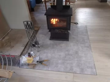

I thought it was time to post an update, and thank the kind folks who answered my questions before. I got the Century 2800 into the house this week and we did our first two small fires yesterday and a bit bigger one today to start curing the paint. It seems to draw well. The tile hearth is not too great because the floor under it is a little bit non-flat, and the tiles are a bit irregular in size, but it's good enough and will do the job of keeping the floor safe from embers. The stove draws well and seems to do fine burning the wood I bought in May and have had stacked in the woodshed with a roof but no walls yet(they will be going on in October, before we start getting snow). It's supposed to get down to 34 tonight and a high of 45 tomorrow, and the mini-split guy hasn't gotten us done yet, so I'm glad for some wood heat.

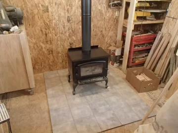

Back in July I bought a SBI (I presume Drolet) Columbia, serial number 577, made in 2013 for $500 from someone on Facebook. This is going to be the workshop stove, and I put down the cement board and tiles for the ember protector tonight. Tomorrow I'm hoping to get the chimney installed, and grout the tiles in the evening. I've failed so far to find much mention online of the Columbia, but have found lots about the Columbia II. The plate on the back shows the required clearances, so that's good, but I'd like to find an online manual to get more details about air control and such. It's built to the 1990 standard, so I'll be curious to see if it visibly smokes more. It's about the same size as the 2800, but on legs instead of a pedestal.
Another thing I'm wondering about is how or whether to lubricate the door handle pivot. It is quite stiff, as the stove has been sitting for a while. I don't know if there is an appropriate high-temperature product or not.

Looking good. Drolet gives names to different products that share common fireboxes but have different trim or stove shielding. I'm not positive, but the Columbia may be the same as the Blackcomb inside. Have you checked Drolet's website for the manual? Looks like it's there:
Graphite powder or Nevr-Seez are good for stove lube applications.

Thank you, that's great. I will check the model number in the morning as it's raining hard now. I had just been googling the name, and I didn't think of going to the Drolet site. I'll get some graphite at the hardware store and see if I can get it in there. Thanks very much for your help.

I used high temp copper anti seize. It probably has more uses around my house than graphite. I did the door handle threads and the hinge pins.
Is your Handle threaded? I recall another thread where the the handle wore out the threads in the door. I think it may have been welded/brazed and retapped. Not sure.

I just wanted to post a final update and say thanks again for all of the help. I got the stove in the workshop hooked up and before I got to the hardware store I made a couple of fires and the door handle got better by itself. I guess maybe the heat helped. It is indeed threaded, and the threads were a bit rusty. Both stoves are working great and I'm enjoying wood burning a lot more with the pretty visible flames and no smoke. It's the opposite of the indoor gasification boilers at the farm where I lived for 21 years which kept the fire hidden most of the time and smoked like crazy whenever their doors were open.
