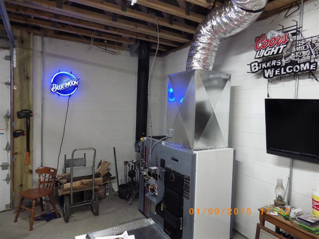

Yeah, they must not do too much wood furnace work...flex duct on wood furnaces is not legal...or wise. Especially right off the supply plenum. If you have a power outage right after you throw a fresh load in...well...things can get pretty hot. Well beyond what the flex duct can handle.None of my H&A guys have ever seen a Yukon

Intake? You mean the secondary air? 3-4 turns out is what Yukon says. I say set it however it seems to work the best for you. Damper? Intake damper should be wire to a FocusPro 6000 thermostatI am just not sure how to optimally adjust my intake and damper.
I find it is hard to get an accurate flue temp downstream of the baro, flue gasses are too diluted with cold air, but not consistant due to fluctuating nature of a baro at work. Get your temp between the baro and the heat exchanger cleanoutflue temp was reading 180 on the vertical pipe above the T

Here's an idea for ya, run the dryer hose over to a bucket, connect the hose to the side of the bucket at the bottom. That will act as a "trap" for the cold air so it doesn't just "flood" your basement. It's more like the furnace/baro "pulls" the air out as needed.
