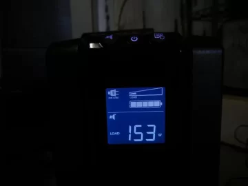

My stove's APC displays power consumption.
As do mine. [Hearth.com] Newb with an amperage insert/FAU questionBut don't do a running tally of power consumed.
Yup, my display is identical.
