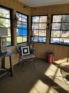

Hi all,
Looking to heat a recently enclosed screened porch. Has vinyl windows and is 16 X 18 ft (288 sq & 2304 cub ft ) So I was leaning to pellet especially seeing the direct horizontal vent. Then a read the strong recommendation to have a riser. Stove I was looking at listed Enviro min mentioned direct vent option. I get the logic in the fail-safe of the application but wanted to know of that was the overall consensus. However I also have the issue with the Vinyl windows. SO questions are.
* Looking to only heat the un-insulated porch more for holidays.. But Im sure if it was convenient my wife would use room more in winter. (Northern IL)
* Recommendation of stove given small size of room. 288 sq ft
*Was hoping to avoid Vertical venting but even with a outside riser I'm right at the window with the termination.
* Also the Enviro mini has a external blower and with the small size of the space, I was hoping to eliminate the noise factor.. However that calls for the 24in riser.
Pic of corner I was looking to put it in..
