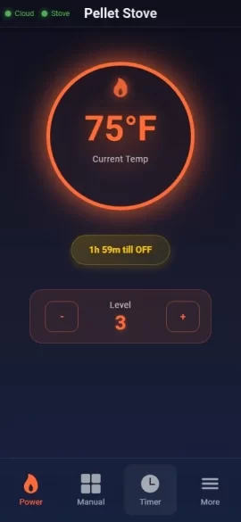

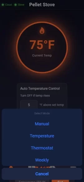

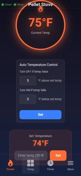

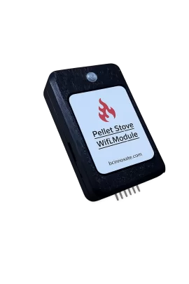

Hi everyone, I have the Castle Serenity Stove that shares the same head unit as the Comfortbilt, I was going to go the Tuya route, but I wanted additional features where I can turn on and off the stove at a certain temperature, and i wanted to have an on and off Timer. So I created my own device with all these features that plugs into the head unit. I thought others might find it useful so I thought I would share it here.
very interested. where can i buy one? My wifi tuya unit is so finnicky
