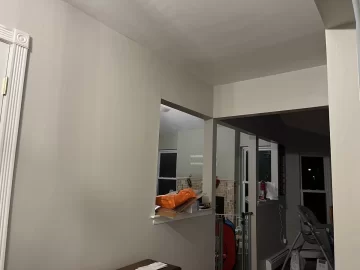

I’m really glad I purchase anything to help move the warm air around. Here’s a shot of the fireplace room. It has vaulted ceilings and the room next to it is a long kitchen with vaulted ceilings. Naturally, the warm air dumps into the kitchen through the walkway into the rooms and the large square cutout.
Then you have the square cutout closest to me in the picture. The warm air dumps out of that cutout and flows along the ceiling behind me. If I turn to the left a little then you have the hallway which leads to 3 bedrooms and a bath. The room I’m standing in has a similar drop down from the ceiling so it’s harder for the warm air to get in there.
This fireplace is literally heating the entire house. Our thermostat is in the hall leading to the bedrooms and it’s reading 4-5 degrees warmer then it would normally be if we were just using the household heat. We even have a baby monitor camera near a window in one of the bedrooms and it usually read about 64 degrees since it was near the window. I’m even that is now reading 69 degrees.
Fireplace has been running for almost 2.5 straight days with outdoor temps ranging from about 20-35 degrees. Our household heat , set to 68, has only been on about 2.5 hours total in the 2.5 days we’ve been running this fireplace. :)
