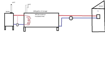

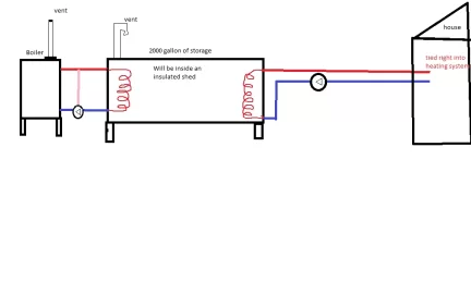

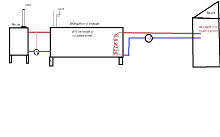

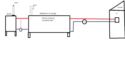

Hi guys, this is my first post and I just want to say thanks for all the info on here. I have done a ton of reading.
I am starting to build a house next spring and want a gasser with storage. what is the best way to hook it up? What are the pros and cons of each?
Thanks
Link Removed Link Removed Link Removed Link Removed

I would use an indoor boiler, in the shed beside your storage tank, and pressurize everything.
Lots of propane tanks in Moncton NB at Tri-Province.
Said without knowing anything about your situation or house etc..
Actually, even though I have a nice gassifier & storage, I would be hard pressed to do it all over again if I was building new today, I think. New construction gives lots of chance for building something that doesn't need much heat to start with - say, maybe a mini-split system or two & a stove to supplement with. Just talking a house, that is.
I haven't really considered a Garn. Are they open or closed?
Maple1 I was expecting that response from you about the mini splits. I have seen you post that before. A little more info. We are looking at building a 2500+\- sq ft house, plus basement and attached garage. I would also like to build a shop down the road. I just bought 25 acres of wood land to put it on so I got lots of fuel. I have a wood stove in my house now for the past 10 years and had one in my parents house for the 20 years before that and I'm kinda getting sick of the mess and bugs in the house. I also like the idea and benefits of in floor radiant heat. And on top of that my wife real hates the look of mini splits and I can't say I disagree with her. Happy wife happy life.
Aside from needing to use a brass circulator and top up the water level every now and then what are the downsides to an open boiler and storage like in the pictures. I plan on having a closed system in the house.

Regular water analysis & treatment - think most do it annually. So the more water you have (either boiler & storage tied together, or a large all in one like a Garn), the more treatment stuff you will need for it. No idea how much that stuff costs. Think that's another example of being on the wrong side of the border - maybe.
So if I went with the design with the 2 coil HX would I still have to treat the water? It would be just sitting there not moving. I'm thinking of a stainless steel tank with home made copper hx.
Some have used old stainless milk tanks like that. Insulated them best they could.
Another option could be a lined wood box type of tank. TomInMaine on here makes & sells those setups - I think his company is American Solartechnics. You could also build the wood part & get a liner from him - lots of flexibility there in getting storage into a tight space.
Anything not stainless, or with the right kind of plastic liner, will be open to corrosion. If it's not the right kind of plastic liner, it will deteriorate from the heat. And neither should require treatment - I don't think.
