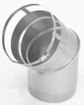

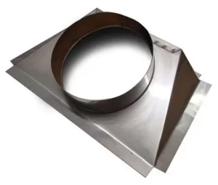

Newbie looking for advice on insert connection - what's the difference in installing one of these
jaychino415
Jan 31, 2013
174
san bruno, ca
Any difference on using either?
Thanks.

Thanks Webbie. Are there any downfalls from using the boot? When I got my used freedom bay insert, it came with the boot. The only thing I can think of is during cleaning all the creosote will drop down on top of insert instead of dropping back into insert. Any thoughts?
