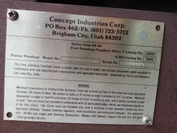

Ive been reading here and I decided on the Englander 30nc then l got this stove for free. Is this stove worth installing. It has a 8" flue and the Englander has a 6" flue. I don't want to install a 8" and find out the stove is no good. Could I put in a 6" and reduce it down and try thus stove then get the Englander if I don't like it?
One thing I thought didn't look right is the pic of the stove from above the flue, its open right to the firebox is that normal? Person I received it from has used it for years and says it works good. I couldn't find any info on this stove.

It's an old Blaze King knock off, never heard of it.
It's not worth installing in my opinion. It's gonna be very inefficient, thus the wide open flue you mentioned.
No, you can not reduce the flue pipe. It needs to be 8". Looks like a locally produced Utah stove from the early 80s. It appears to be in decent condition. The stove won't win any beauty contest, and will probably eat wood like candy, but it should be safe to install if no defects and if installed respecting or exceeding the required clearances on the label.

Secondary combustion system to increase efficency and reduce emissions. UL listings to make your insurance company happy. Reduced clearances so you can put it closer to the wall. Warantee and availability of parts if anything goes wrong. Just to name a few. I have no problem at all with old stoves but none of us know anything about that one there are good old ones and not very good old ones and with out knowing on that one i wouldn't put the money into an 8" stack for it

Back to the original picture of that stove, does it have a bi-metallic thermostat on it? Also looks like it has a bypass lever of some sort. Interesting stove.
The closest I can find on the Safire Gem is some newspaper ads: http://www.newspapers.com/newspage/53301457/
Another newspaper ad with your exact stove: http://news.google.com/newspapers?n...zRTAAAAIBAJ&sjid=IYMDAAAAIBAJ&pg=4364,5055976
http://ogden-ut.americanlisted.com/misc-household/wood-burning-stove-250-brigham-city_20913147.html <-- so it does have a bi-metallic switch on it.

Can't believe you found those ads, pretty cool. The concensous seems to be its not worth installing, do you have an opinion? Not sure what a bit metallic switch is.

My 2cents would be that stove would be a great workshop/garage stove, for your house I would get something newer, especially if you are putting in new chimney pipe, why go through all that expense to put in something that is close to 30 years old.
Keep searching for a newer used stove, they are out there.
I would check out this Country Hearth, it says it comes with piping: (broken link removed to http://dayton.craigslist.org/for/4680853908.html)
Check the woodstove over really good for any cracks or signs of overheating (paint turns white/warping). Maybe you can get the guy to include the class A piping with that.
