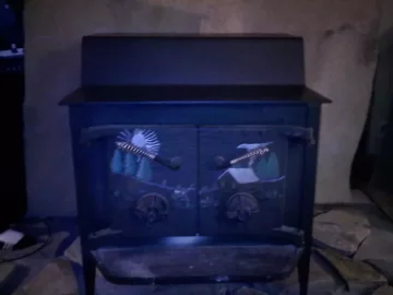

Here is what I currently have in my living room. After some research it almost looks like a Fisher but no markings whatsoever on it. I would love to get a new stove but it is not in the budget this year. Maybe an upgrade in the near future. I thought the tax credit would be a good deal but its only 30% of the stove and would not include the installation, at least that is how one of the stores explained it to me.
Do you guys know what kind of stove this is?

Your old steptop looks to be in fairly good condition. If it has a baffle, it could be ok for a season especially if money is tight. Does it take a 6" or 8" flue? Did you check on the back for a UL label?
It is in pretty good condition but not sure where a baffle would be located. There is not a whole lot to it other than the bricks inside. It is an 8" Flue and I do not see any labels on this thing at all. I looked all over with a bright light and wiped the whole thing down. Since I cannot find a manual for it im nevous about how much floor protection I need for it.

Had to chime in here...your insert looks like one i have as my fireplace insert...mine is made by "Kodiak" in Alaska i think...i have tried doing searches on it but think they have went out of business but you can still find pics of the stoves..no catalatic converter in them,only firebricks...i use mine during the winter and it saved my butt when i was without power for three days a couple years ago as could not use my outside wood furnace without electric...i use my insert more than not and it heats the 1900 sq; ft house just fine..i also got a blower that goes on the bottom of mine but hardly use it as it gets to hot unless its really cold out like around 0......
mine is smaller than the fireplace opening so there is a guess its called shroud around it...the opening for the pipe just goes into the fireplace chimney...no problems at all...and fairly easy on wood.......hope this helps some......
