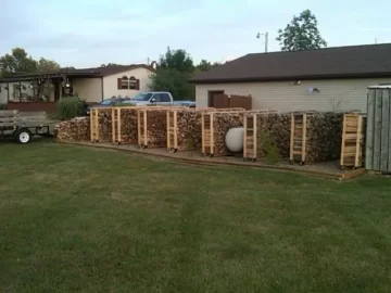

Here is a pic of the Woodpiles. Unrelated...

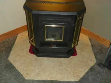

Countryboy- that was a relevant story indeed! My stove has been in the basement (from being delivered- not staying down there), and about once a day I go down, and just look at it! It's appearance gets more attractive every time I look at it. Will be fun to have in the living room. Going to start building the hearth soon so I can get it up here and get it installed. Can't wait!

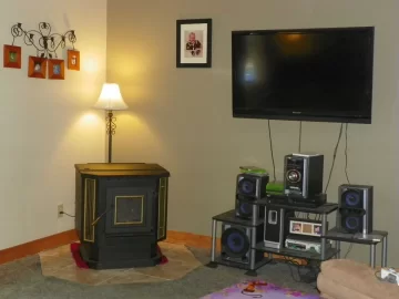

Well, heating season underway and I have been VERY impressed so far with the mighty mouse's performance. The master bedroom in my house is approximately 50 feet from my stove, down a hallway, has an exterior door, and 2 large windows. It has always been the coldest room in the house, roughly 4 degrees colder than the rest of the house, sometimes more. The lowest we have seen here in Wisconsin so far has been 20 degrees, and with a fan on the floor in the doorway, blowing TOWARDS the stove (blows cold air towards living room, forcing warm air into the bedroom as someone recommended) keeps my bedroom VERY warm. So far with the 20 degree overnights we have had, the stove will be on heat setting 3, blower speed 9. Bottom settings I have been toying with so far @ 4-6-1 keeps the house at about 72, probably 75 or warmer in the living room. That puts me at about a bag and a 1/2 a day. I have just finished up a pallet of Risley, which I could not fairly give a review on, as I have nothing to compare to. I will say I was happy with them. Ash content seemed pleasingly appropriate. I only needed to dump the burn pot every other day if I kept it running, sometimes could go longer. However I noticed a warmer heat if I cleaned it daily. Will be interested to see how she holds up to colder weather as the heating season progresses. I would rather burn 3 bags a day than turn on the propane furnace. On the not-so-cold days 35+ I can get away with heat setting 1, keep the blower speed on 9, and 4-6-1 lower settings. That uses a bag a day. My guess is on our sub zero days, I will have to kick on the propane furnace, but we'll see. On those days, we may all just camp out in the living room for the night, we'll see. Going to try Indeck brand pellets next for a comparison. Sure wish I could get my hands on some Uncle Jeds, but so far no luck within a reasonable driving range.
Surge Protector ?? Nice install......
No need for Propane. Just crank the heat up and let that puppy (mousey) purr all day long.
Even burning 3 bags a day is better and cheaper than Propane (ProPain). Heck even if I had to burn 10 bags a day, I would still have savings over Propane (about $3,800 a yr w/ LP). Wont catch me flipping a LP t-stat till I cant care for the stoves anymore. Even then, I still may burn. Thats what I had kids for.

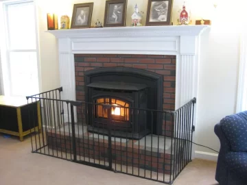

Hi longlivethejeep, nice looking install! you will enjoy the heat your pellet stove produces for many seasons to come.
I too have a 2 year old, a boy, and he loves to climb. I installed a Kidco fireplace gate and it works great. Super rugged and the door is just big enough to allow access to stove.
I made an attempt to attache a picture. And here is a link to the web site (broken link removed to http://www.kidco.com/main.taf?erube_fh=kidco&kidco;.submit.safetfyGatesByCategory=1&kidco;.categoryid=5&kidco;.bc=gc)
