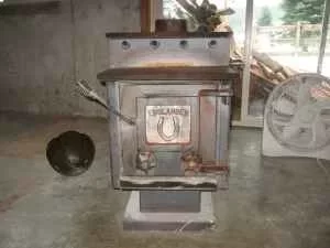

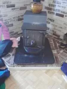

I ran across a Fisher Baby Bear for $225 and an Englander 24-fc124-ac (has the blower) for $275. I have been reading about the Englander stove but cannot find specific info on this non-glass door model which has a horse shoe on the front. Both stoves are in pretty good shape with no rust in the Fisher and minimal surface rust on the Englander. My uncle has a similar model Englander that has a 14+ hour burn time.
As I read more about stoves, I am concerned that I may have acted too rashly due to EPA ratings. I plan on the the Fisher for the guest home and hope to get 8+ hours of burn time out of it.
In regards to the Englander, are there restrictions that I should be aware of? I have buyers for both stoves should they not pan out as I would like.
learned a bit about these stoves today. Mike at England Stove Works was gracious enough to entertain my questions.
Lessons learned:
Englander 24 AC- decent stove heats to 2200 Sq Ft and meets EPA guidlines- built in 1991 (its in pretty good shape too).
Fisher Baby Bear- probably will need to wait for my equipment shed to be enclosed or my garage to be enlarged.
