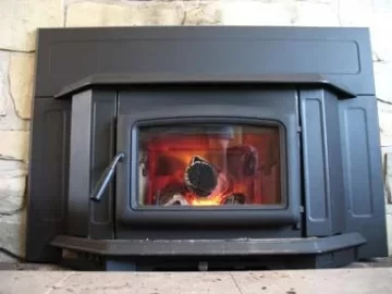

Having moved into our first house with a fireplace, we're looking for a stove solution for a fireplace 27" wide x 24 1/2" tall and 20" deep with a slate hearth of 15" x 60".
After multiple internet searches and three dealer visits we thought we had the solution, the Hearthstone Homestead. However when we discovered that with 4" legs the 6.6 R-value requirement our current hearth would not suffice and it would be a costly if not impossible task to accomplish.
So now I'm considering looking into the Hearthstone Heritage as it only requires much less of an r-value, though I can't seem to confirm this on Hearthstone's site, but some say all that is needed is an ember pad.
My concern is that this stove may be slightly too tall by as little as an inch. Would it be unheard of to remove my existing hearth and reinstall a hearth that is slightly recessed into the floor?

I think I've found my solution. An Enviro insert, the Kodiac 1700. The reviews I've read are great, burns a 20 inch log and puts out 74,000 btu's and looks like it will fit into my small sized fireplace. Anky feedback would be greatly appreciated!

I've encountered yet another issue. I thought I was home free because the Enviro brochure states that the Kodiak requires a 27" x 19" opening. I downloaded all the files only to find that the Owner's manual states the Kodiak has a 17 3/4" opening. Then I saw the fine print on the brochure stating that actual sizes may vary. My opening is on the floor and exactly 27 wide by 24 1/2 tall.
The local dealer told me they can measure for me, but it's gonna take between a week to 3 weeks. I called Enviro and they quickly gave me another number to call which wound up to be another dealer who said some installers will "shave" the stone if necessary.
Another issue is that although the opening is 27w x 24 1/2 tall, in the fireplace there is a metal insert which is about an inch wider on either side but the sides taper inward such that the rear width is slightly over 22". The total depth is just over 20" so it's really a close call if the Enviro would fit.
And...the owner's manual on page 18 shows a drawing of the stove and the rear is shown being 24 1/4" wide but on page 14 of the Owner's Manual it states the following for fireplace size...minimum width in front is 27, minimum width in the rear is 22 3/8" at a depth of 18".
The chart also has two columns one for Masonry another for Zero Clearance. Can someone explain this? I am most appreciative of everyone's advice. I must comment that I'm not impressed with Enviro's customer service and the asence of a customer service phone line. We looked it up in the Canadian Yellow pages. Your feedback is greatly appreciated, getting cold in snowy Delaware, Dave

I am really hoping I have enough room for the Enviro 1700 to fit. I like the 20" log size and its efficiency. If it won't fit, there's an outside chance that a Regency i2400 may, followed closely by the Osburn 1600.
Well Kudos to Pacific Energy and their web site! I found their site the best yet to offer specs that illustrate the needed fireplace size and floor protection. And the best news of all, that the Pacific Energy Super will definitely fit my fireplace. The log size of 18" is less than the Enviro's 20" and that is a concession, but I know for a fact it will fit. Seems like the PE Super Insert is getting good reviews. Now I need to find a dealer near Delaware. Any feedback on the PE units?

Finally a solution...The Pacific Energy Super Insert will fit. Several others may fit, but thanks to the information provided on the Pacific Energy web site this wood insert is a go. I stopped by my local dealer and discussed the is it possible inserts with the yeah, it will fit and the only solution on paper is the PE super insert.

With a confirmed fit and finally installed the Pacific Energy Super Insert is working nicely. I wrote a detailed suggestion list on a previous post pertaining to its installation and if installing a PE Super into a small fireplace opening with a house that's really air tight, the PE tech reps recommended removing the Outside Air (O/A) cover. The cover can be removed after installation with a little wiggling and jiggling.
I'll also add, if you don't have confirmed 1+ year seasoned wood, start your burns using some store bought kiln dried wood. It will take several burn cycles to dry the fire bricks before stove really cranks and once it does I'm confident you'll be quite satisfied.
PE's customer service has been fantastic and receptive of my questions. The installation went well but if moving the fan switch from the right side to the left side it MUST be moved BEFORE the stove is installed. The slip in panels covering the fans, which are periodically removed for cleaning though being just a slip fit were not easy to install and ultimately I may add a handle as there is nothing to grip them. Please note I have a Design-E insert and the panel installation is sligtly different than the Design-D version.
Again, I suggest reading my other posts relating to my recent stove installation experience. Between this forum, PE's technical service and my wood burning neighbor, we are thoroughly pleased with our Pacific Energy Super Insert. Here's a photo of the stove in action this morning. The air control is set centered between Hi and Lo. It's 39F outside and 67F in the house and the oil furnace is turned off.[Hearth.com] Newbie with small fireplace Looking for a Stove Solution
