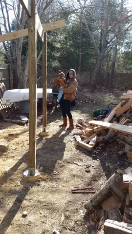

Ground never froze so i was able to dig 42 in footings for the posts
[Hearth.com] No more tarps
My 2 supervisors

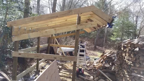

Had a buddy help with the footings, but did framing myself. Not recommended but i wanted to get it done.

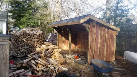

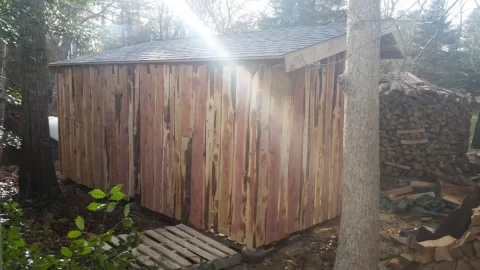

Scored some nice locally milled red cedar on craigslist for the sides and back. 1/2 inch gaps inbetween boards for some airflow.

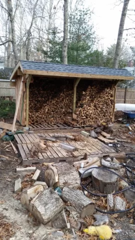

Pallets for the floor.
Only have a little over a half acre so had to load right away to make room.

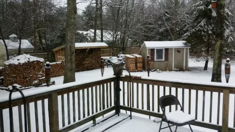

View from the deck. Happy easter and keep your woodpile dry!
  • [Hearth.com] No more tarps

The cedar siding looks awesome! Nice job
Nice shed there. Great job!
great job, love the siding. good riddance to tarps!
Nice find on the cedar! Cannot beat the look.
That is the first shed I've seen with cedar siding. Now that will be the standard for firewood shed siding from here on through. Very nice work.
Was going to use t-111 but when I found the cedar i couldn't resist.
