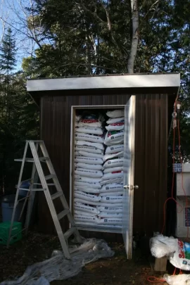

Obviously I do need a storage area and I see you mentioned you are using a metal shed, does this keep them secure enough from damp? Do you move the bags into the house in the fall?
We removed part of the decking around the house and the 2x6s were still sound so I re-used them for framing the shed. There was a metal door w/frame at the local landfill. I had to buy a sheet of plywood and the metal siding for the sides and roof. Photo of it loaded ... Three pallets of Spruce Pointes!
3 tones crammed in there like sardines, and no issues with damp?I could easily do something like this.Only issue I see is lugging bags of pellets into the house in the dead of winter. Do you ever keep extra leftover bags stored in there over to the next season without issues?
No issues with damp ... The lugging in isn't so bad and far better than being in the house as there can be issues with pellets off-gassing. Had around 40 bags that sat all summer and burned just fine. The build went a whole lot easier since I snagged the Hubby's Paslode. Used his grinder with cut-off wheel to cut the tin to size. Hubby helped with securing the roof tin:)
Does the shed have any ventilation is is it completely closed in?
Only problem I see with that shed is the same one I have with my wood shed. If it doesn't have a back door if you don't burn everything in it every year, year after year, you end up with some really old stuff in the back.
Slight openings under the eves on the sides.
BB, difference with pellets is I don't buy enough at one shot to keep me going for the next three years... I had 20 bags to move out of the way to start fresh. Compared to stacking the new 180, not a big deal. Gets interesting when you get up by the roof line ... think I only smacked my head a couple times this year;lol
